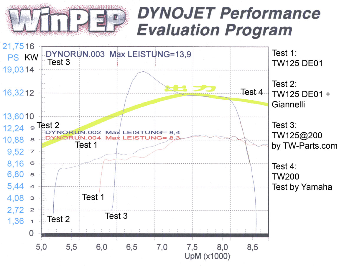

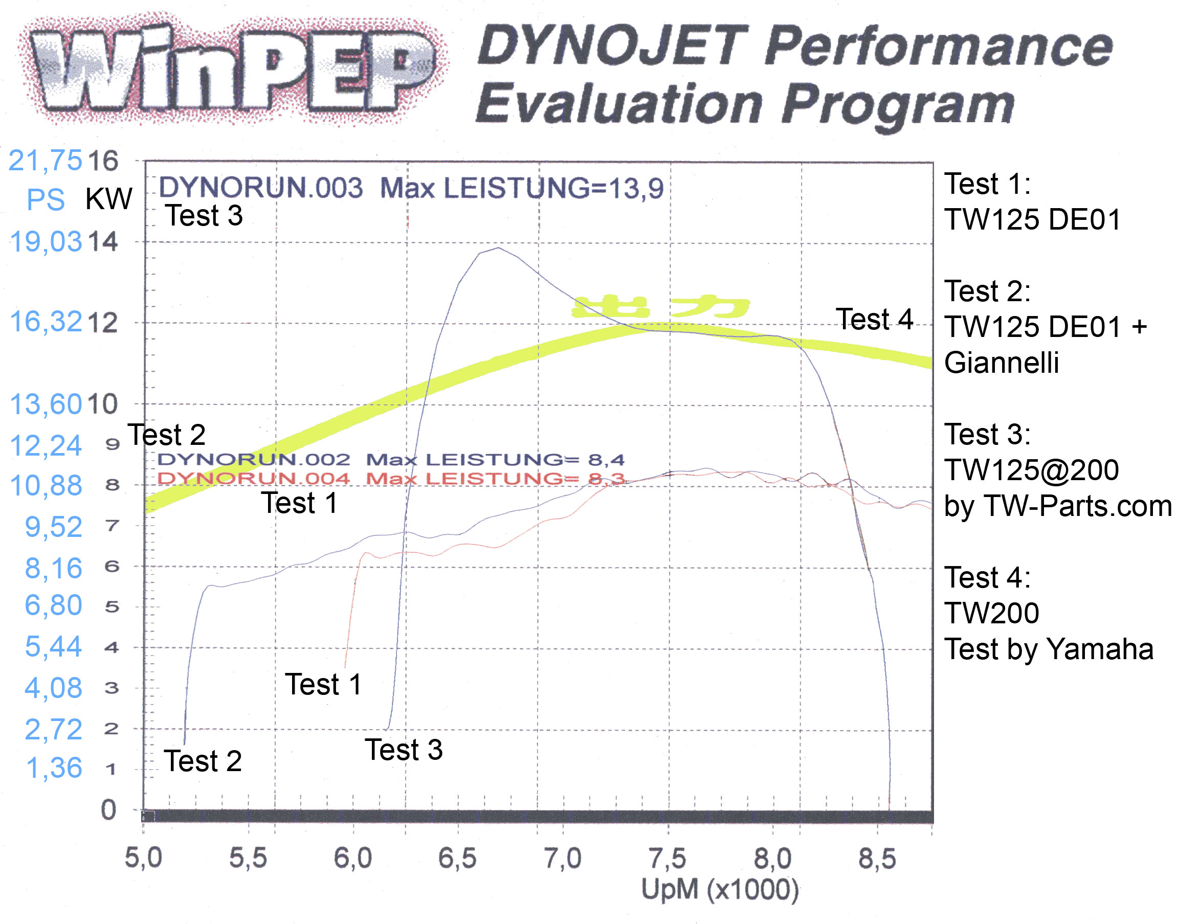

I made today (Saturday) some tests with a friend and his TW125 and my TW200 on a Dynojet Performace test stand (banc d'essai/banc d'épreuve).
The tested bikes:
Test 1
Bike: Yamaha TW125
Type: DE01
Engine: 125ccm
Modifications: -----
Test 2
Bike: Yamaha TW125
Type: DE01
Engine: 125ccm
Modifications: Giannelli exhaust (nearly identical with the G.P.R. exhaust)
Test 3 (my bike)
Bike: Yamaha TW125
Type: DE01
Engine: 200ccm (cylinderhead, cylinder, crankshaft)
Modifications: high compression piston, Mikuni VM28-418, bigger outlet, YZ450F exhaust
Test 4 (from a Yamaha cataloge)
Bike: Yamaha TW200
Engine: 200ccm
Modifications: ---
picture download big - 2303 x 1807
picture download middle - 1150 x 902
picture download small - 800 x 628
And here are the results:
Test 1
Bike: Yamaha TW125
Max. power: 11,42 PS/CH
Test 2
Bike: Yamaha TW125 with Giannelli exhaust
Max. power: 11,28 PS/CH
Test 3 (my bike)
Bike: Yamaha TW125@200ccm
Max. power: 18,90 PS/CH
Bike: Yamaha TW200
Engine: 200ccm
Max. power: 16 PS/CH
You see, for the TW200 ~3PS/CH more power (with still 200 ccm) with a high compression piston (from 9,5:1 to 10,25:1), the Mikuni flatside carb and a optimised outlet.
My Mikuni is not perfect adjusted, the mixture is a bit too rich (too much fuel). I had some missfire on the test stand.
I will add soon some pictures from the test's.
Questions?
Salut, Sebastian

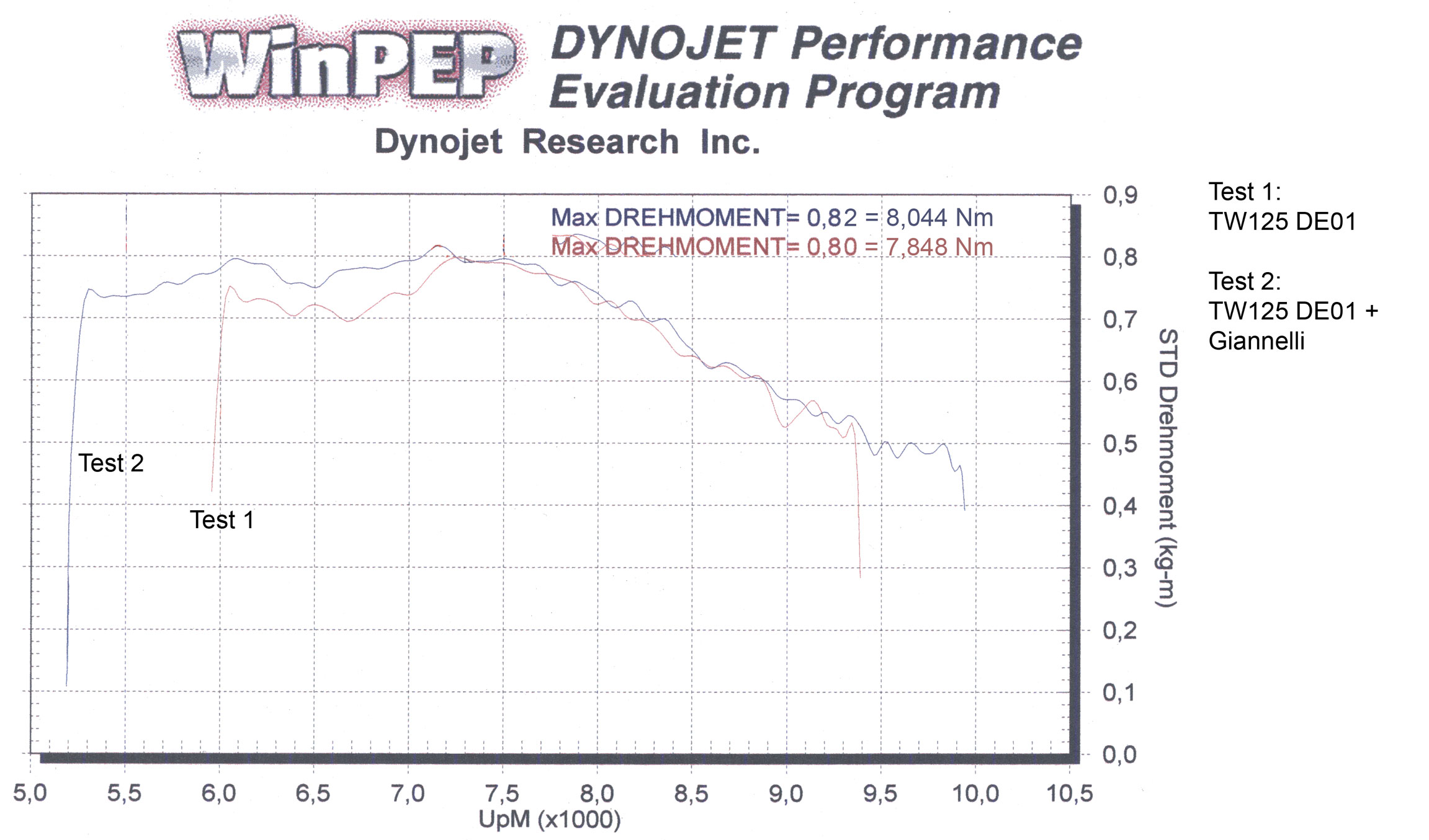

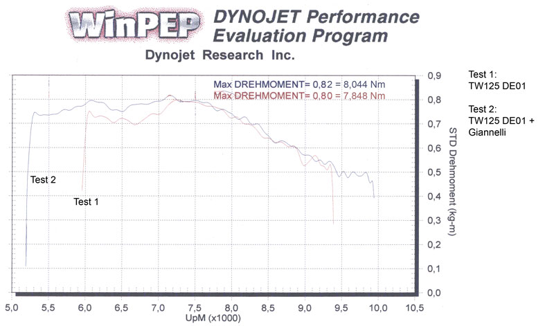

Why?
Just the max. performance is just 0,1kW (= 0,14 PS/CH) lower. But the performace is in the lower rpm 0,4-0,8kW (= 0,54-1,09 PS/CH) higher as with the org. exhaust.
Take a look on the Nm (just the TW125)
picture download big - 2303 x 1355
picture download middle - 1150 x 677
picture download small - 800 x 471
The results:
Test 1
Bike: Yamaha TW125
Max. torque: 0,8 kgm = 7,848 Nm
Test 2
Max. torque: 0,82 kgm = 8,044 Nm
Max. raise torque: +0,19 kgm = +1,864 Nm -> +13%
Result: Giannelli does not suck!
You have to look on the complete rpm range, not just the max performance. You will have compareable results with all the other exhaust systems on the market.
